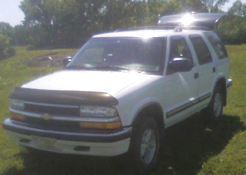

replace rear transfer case seal, leveled center drag link, re-tighten exhaust flange, replace all four tire (235 75 R15) removed & clean throttle body. repaired driver's side door speaker blazerleft.jpg
