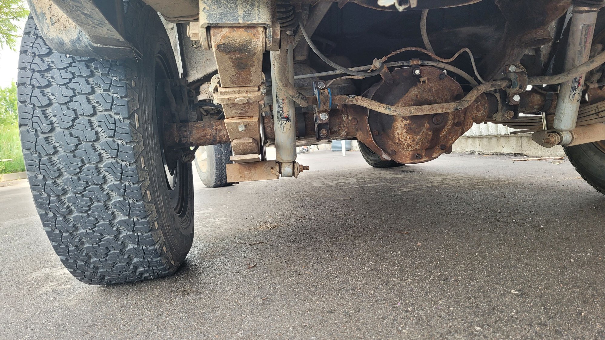

But for a little more comparison, hears the 4x4 axle on the jimmy, and the zr2 axle on the blazer
Both have 2wd rims. Jimmy has 80s camaro rims, and blazer has the zq8 rims. Believe to be the same back spacing...

So I managed to get a zr2 read diff on Wednesday for 175 complete with brakes (was -45 with the wind when I pulled it out). Just finished putting it in had to get a moog 447 conversion ujoint but it seems I can’t line up the sway to put it back on. How is yours all lined up?
Old Jan 10, 2022 | 01:14 AM
  #607
I actually used a couple of the u bolts that held the leaf spring/shock mount brackets into place, as I got a new set made.
I can get a pic tomorrow, hopefully my drunk *** remembers lol...
Edit: the rc lift came with a couple of brackets, that move thw sway bar location. You can see in the axle pic above(slightly). I can also get a better pic of them if needed.
