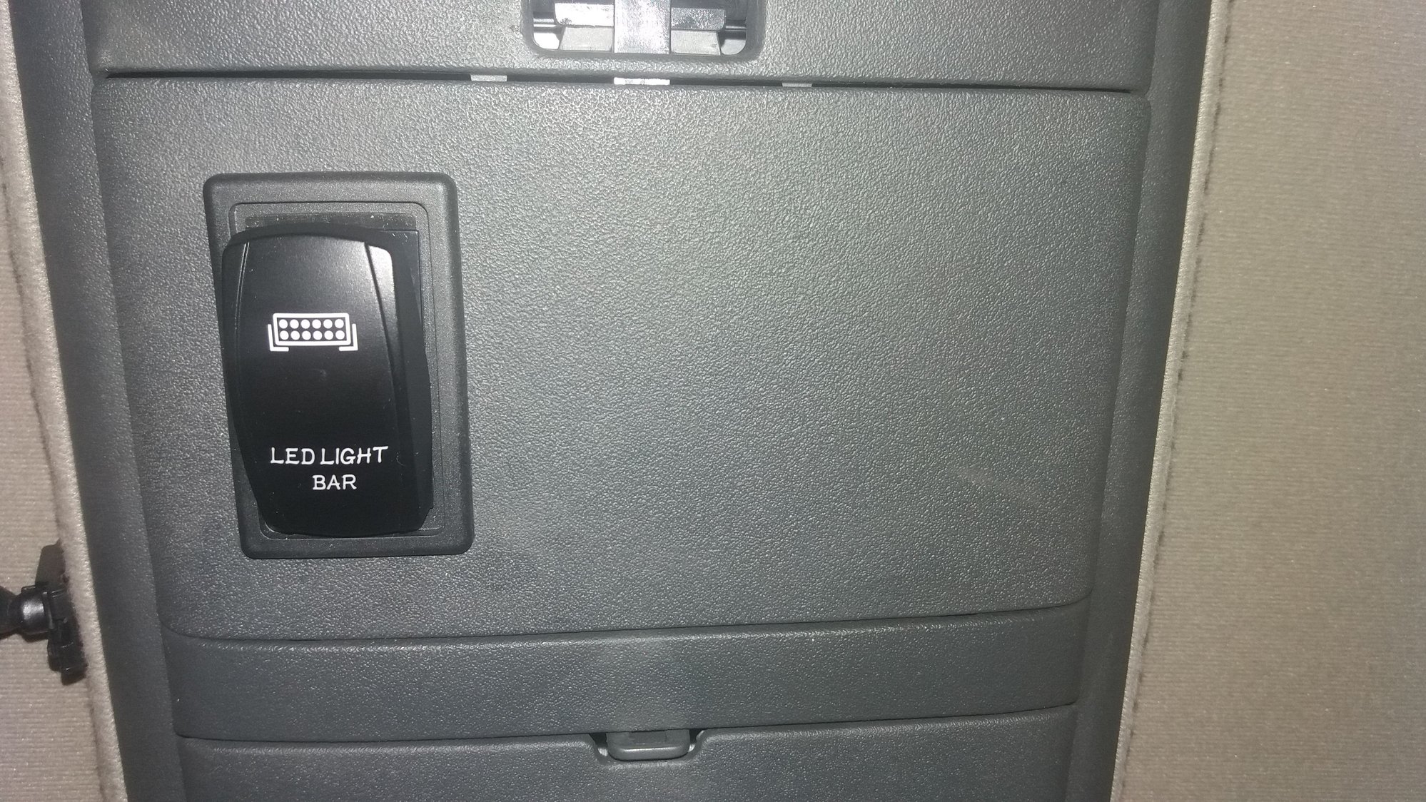

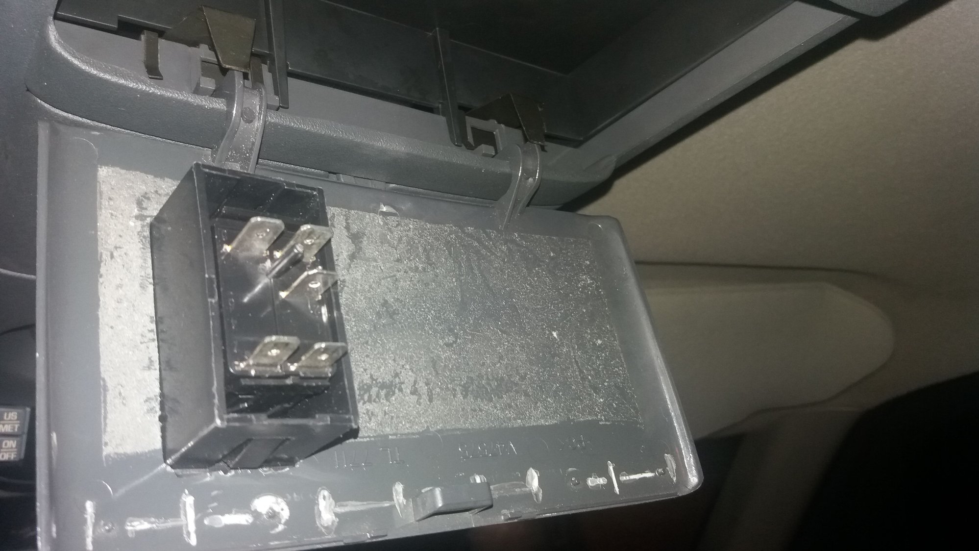

A little bit of an update: I got my switch mounted for my off-road lights.
I mounted it in my overhead console. I modified the sunglasses holder. Turned out pretty well, I think.

The wiring harness that came with the lights wasn't going to work as-is so I bought 3 spools of wire and spliced the connectors for the switch. Now it will be long enough to reach the battery.
