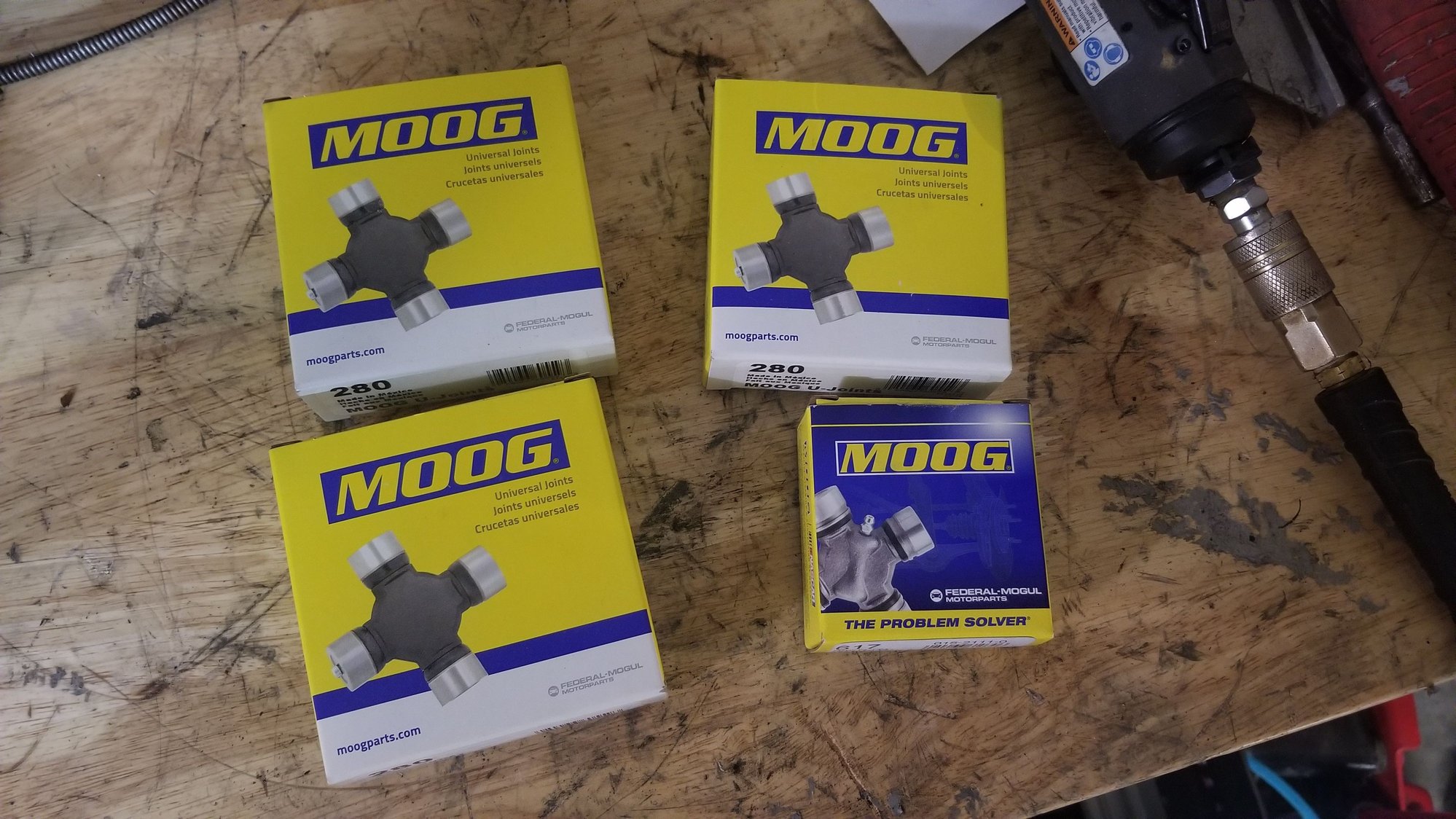

My ujoints came today
Figured I might as well rebuild that front driveshaft. No telling how many miles might have been on it.
Decided against having it balanced, didn't want to spend the money, and with the tcase engaged there is no vibration, even up to 60 mph, so I'm gonna consider it good.

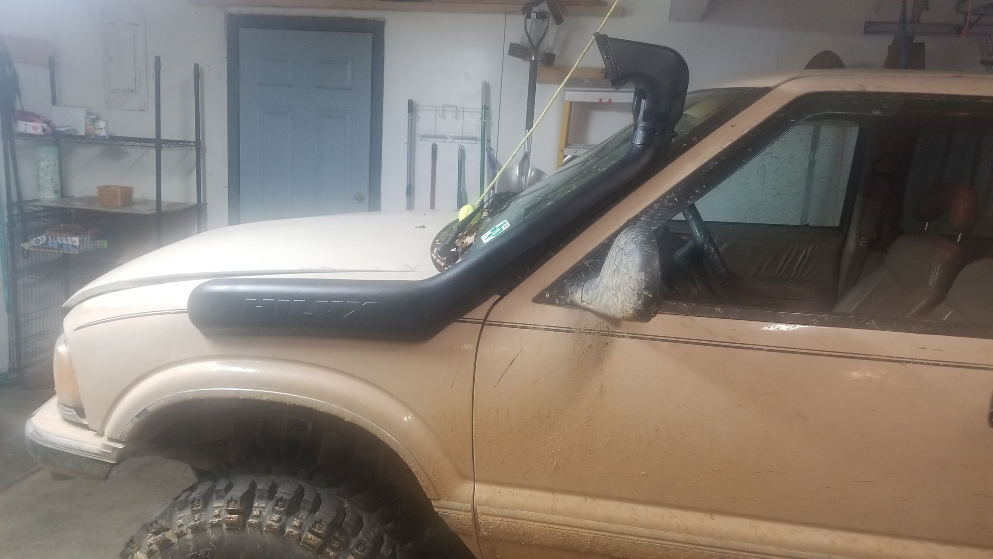

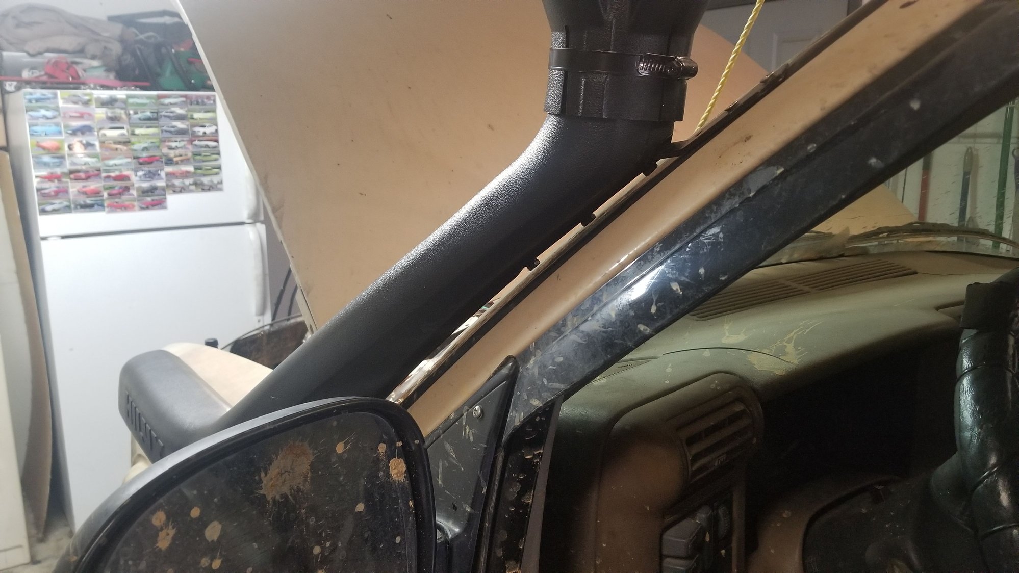

Got the outside of the snorkel finished up this morning. It's not a perfect fit, but I hit the angle with a heat gun, and gently pulled it down towards the A pillar. There's a little gap between them, but nothing I can't live with
Been working on moving a bunch of wire harnesses into the inner fender, in preparation of installing the new air filter housing. I had to cut and lengthen one factory harness, but it was only four wires.
I'm having to move my relay panel towards the firewall about an inch and a half, then I can start figuring out how to connect the snorkel to the throttle body

​​​​​Couple quick pics to give y'all an idea what it looks like
