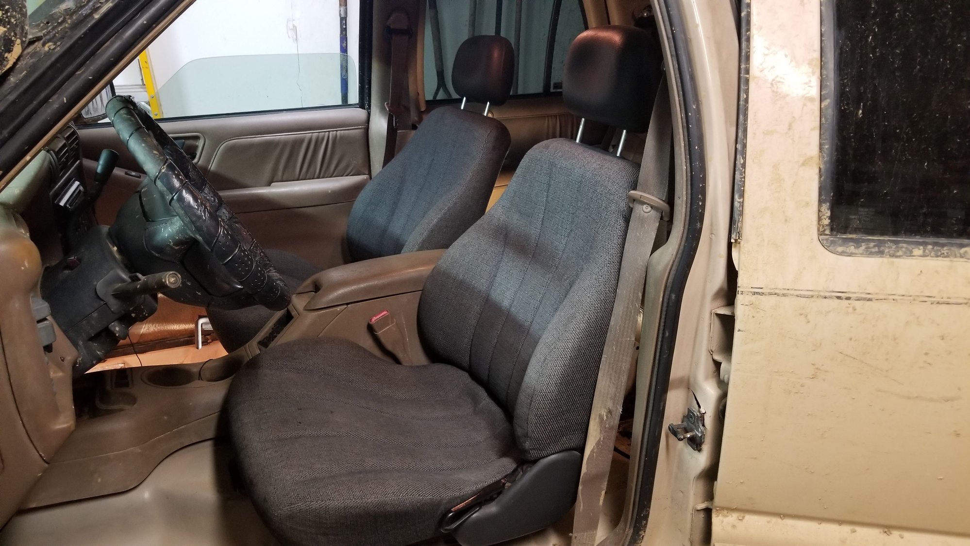

The seat swap must not have been too bad. It literally unbolted and then rebolted to the s10 seat rails? I think in the 98+, there might be some more to it... I'll have to experiment next weekend.
Yes. The cavilier seats literally bolted to the S10 seat rails, with bolted in directly to the studs on the floor board of my truck. Now, the S10 was a 95-97, as is my truck. I think on the 98+ trucks, you have to drill a hole, in the cavilier seats I believe, but it's still a very simple swap, from what I've read.
They're pretty comfy, I didn't notice them sitting any lower than the stock seats, and I really like the side bolsters so far.
