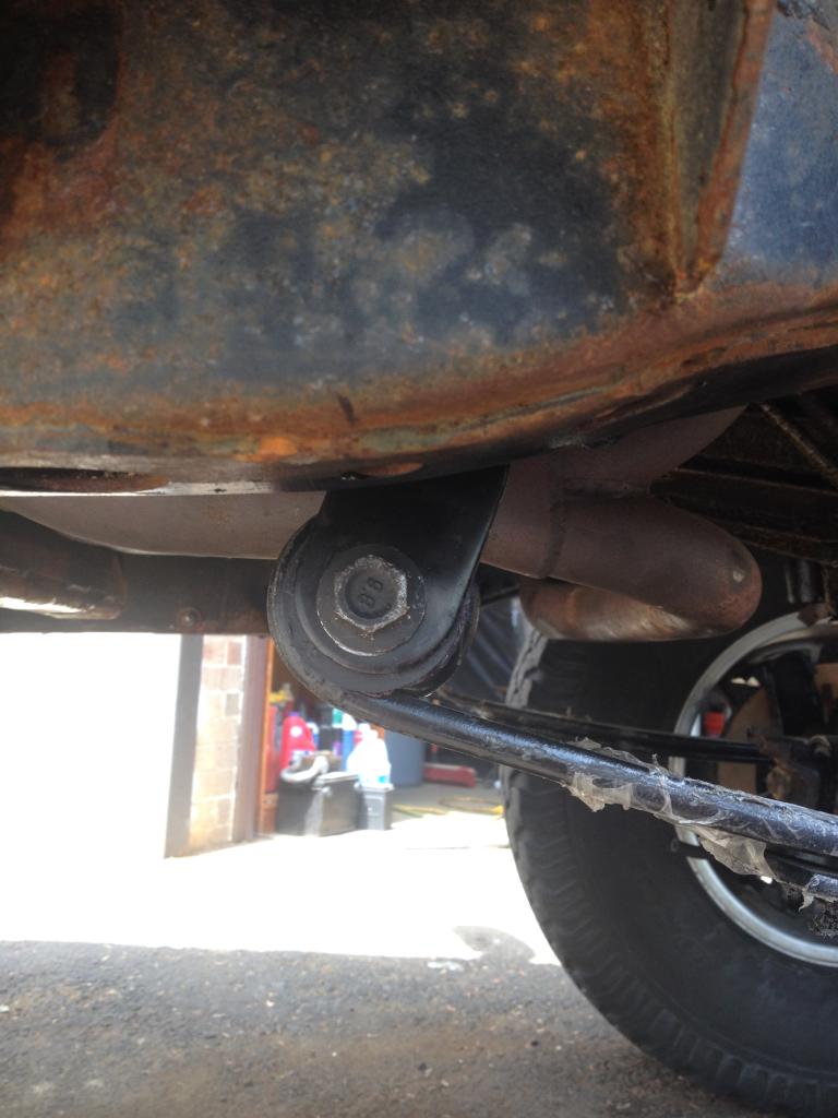

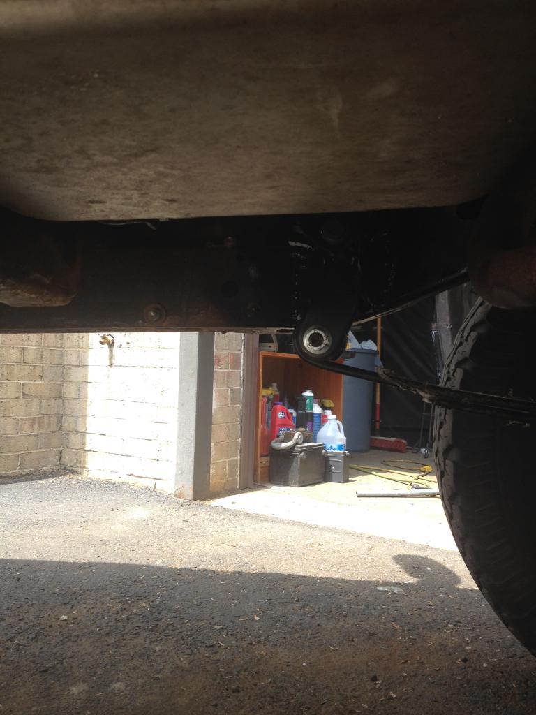

Got the passenger side spring pulled, burned in the rear hanger and put everything back together today. With one leaf removed from each side the front came down about 1.5" which makes me happy and is about where I want to be at. Before the front center of fender was right at 49" now its at 47.5". Hopefully monday afternoon I will be able to get the leaves put into the rear packs and bring that up a bit. After everything was together I rocked the **** outta it to help things work into place a bit since I can't drive it yet and ended up with a pretty decent shackle angle at about 5-6 deg. The pics aren't the greatest but you can see the angle pretty well.
Attached Thumbnails My small 96 Blazer build-11878df2-f988-446a-9d1e-40233896518c_zpsgkxytncf.jpg   My small 96 Blazer build-cf8d843e-0062-433e-aab7-e29f1dddc69c_zps6tsusq1f.jpg

Looks good rex, now we need some updated side pics

From: Northern VA
I'll get some on Monday after I get the rear sorted out
