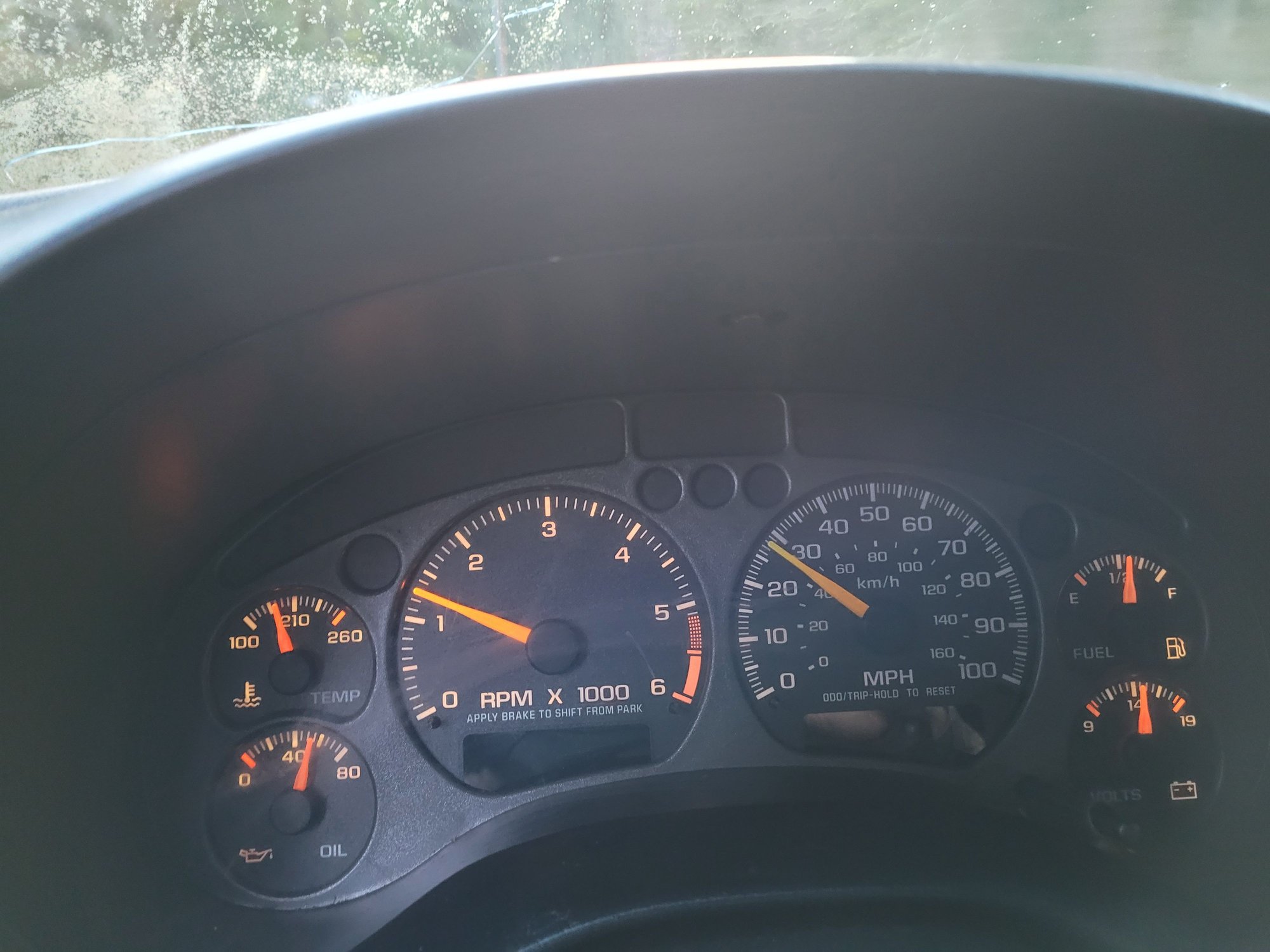

Made the run down to the Blazer again today (spring break '23 baby!) and gave it some more love.
*More fresh fuel added along with more seafoam. *Changed the oil (last change sticker said July 2016!)
*Bled the brakes and gave it new fluid.
*Flushed the HELL out of the radiator/reservoir/block and gave it all new coolant.
*Topped up the power steering fluid.
*Fixed the codes: Mass Air Flow wires chewed down to 1 out of 3. Spliced in 2 temp wires).
*Found a "random" yellow wire up by the oil filter that was severed and fixed that.
Drove it for about 3 miles, let it idle for 2 hours, then ran it for 15 miles. No longer sounds like an old tractor! It's running better than it did before I parked it now.

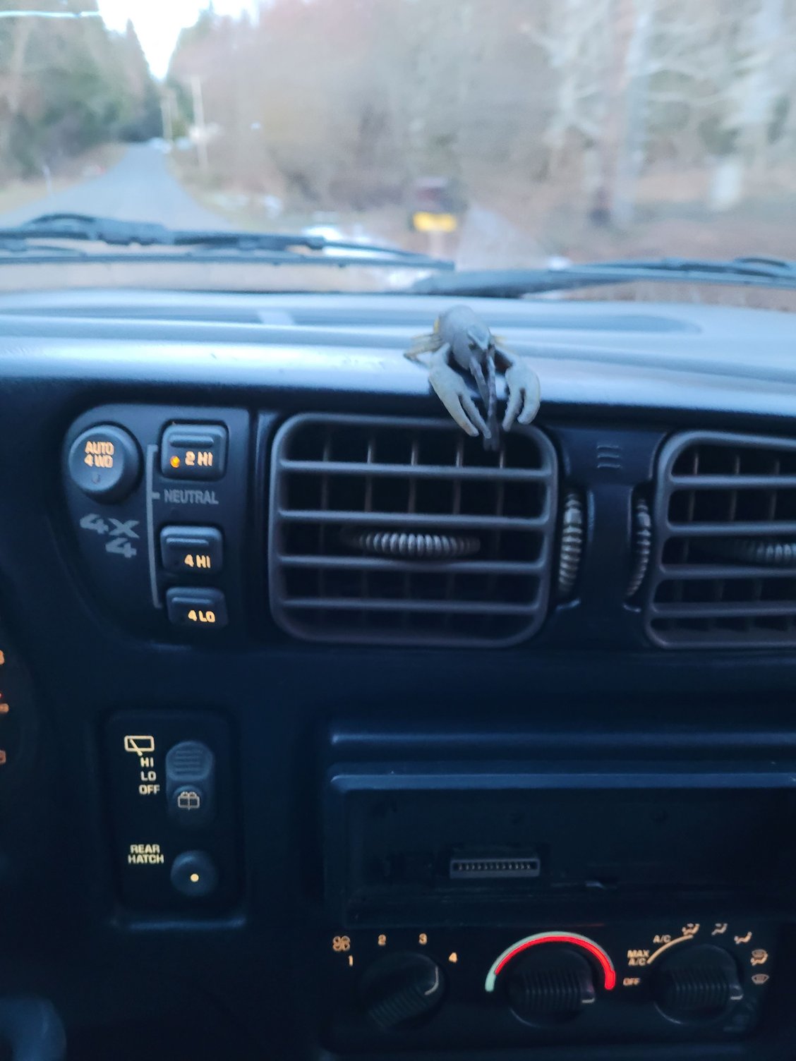

A number of issues were found:
^heater/ac doesn't work
^exhaust leak looks to be at the D side flange above the O2 sensor...
^P side CV is blown...
^Rear lift glass and hatch won't unlock...
^Odometer, gear indicator, and half of the speedometer doesn't light up...
Aaaannndddd about a million other little things are stacking up.
If all goes to plan it should be trailered up and in the side yard this time next week.
Most of a dash cluster!
