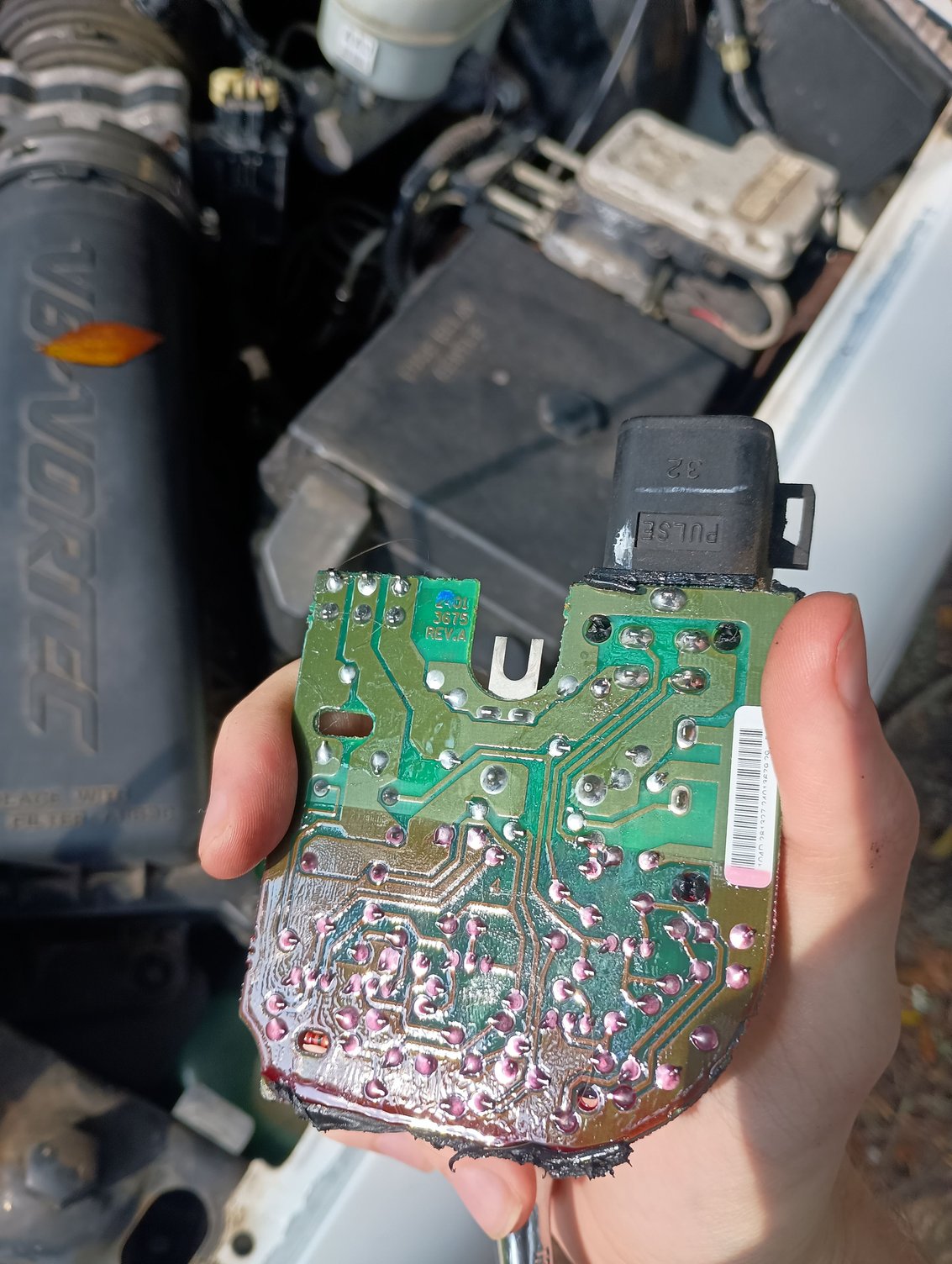

-I also resoldered the wiper pulse board. 3 t20 screws and a connecter are all it takes to remove, so very easy. My issue was the wipers wouldn't stop if I used mist or the washers. I found a few cracked joints on the board, so fixed those. Now the wipers stop as they should!

Nice repair on the circuit board!
Excellent. I remember doing the reflow on the pulse board a few years ago. Still working fine.

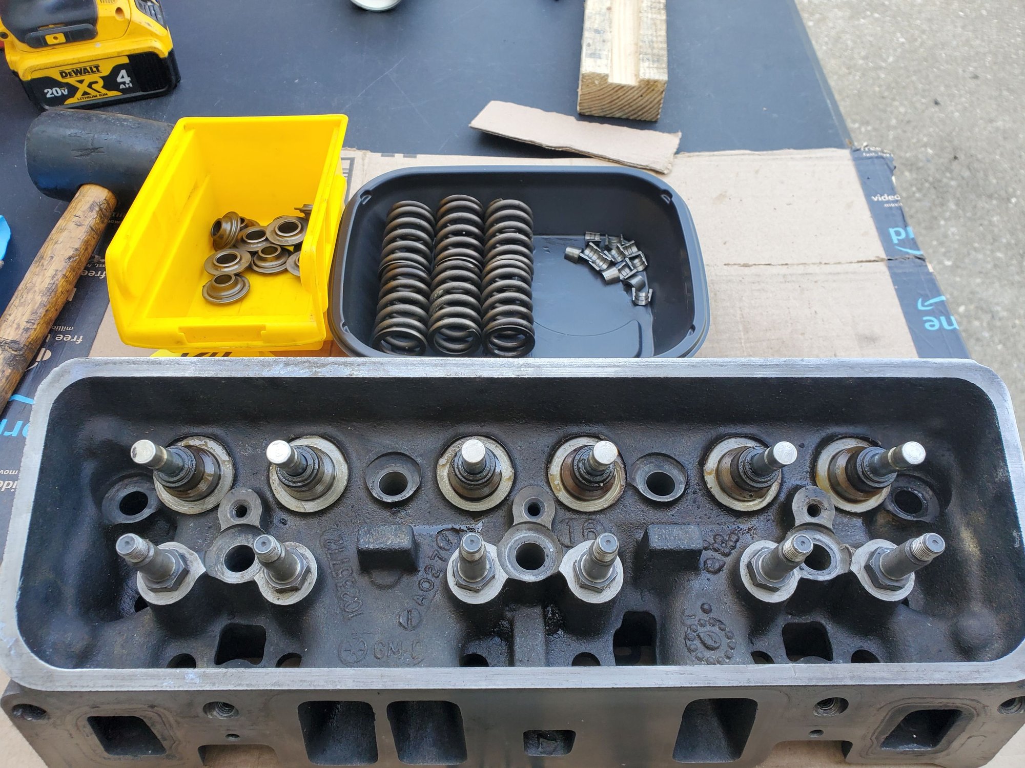

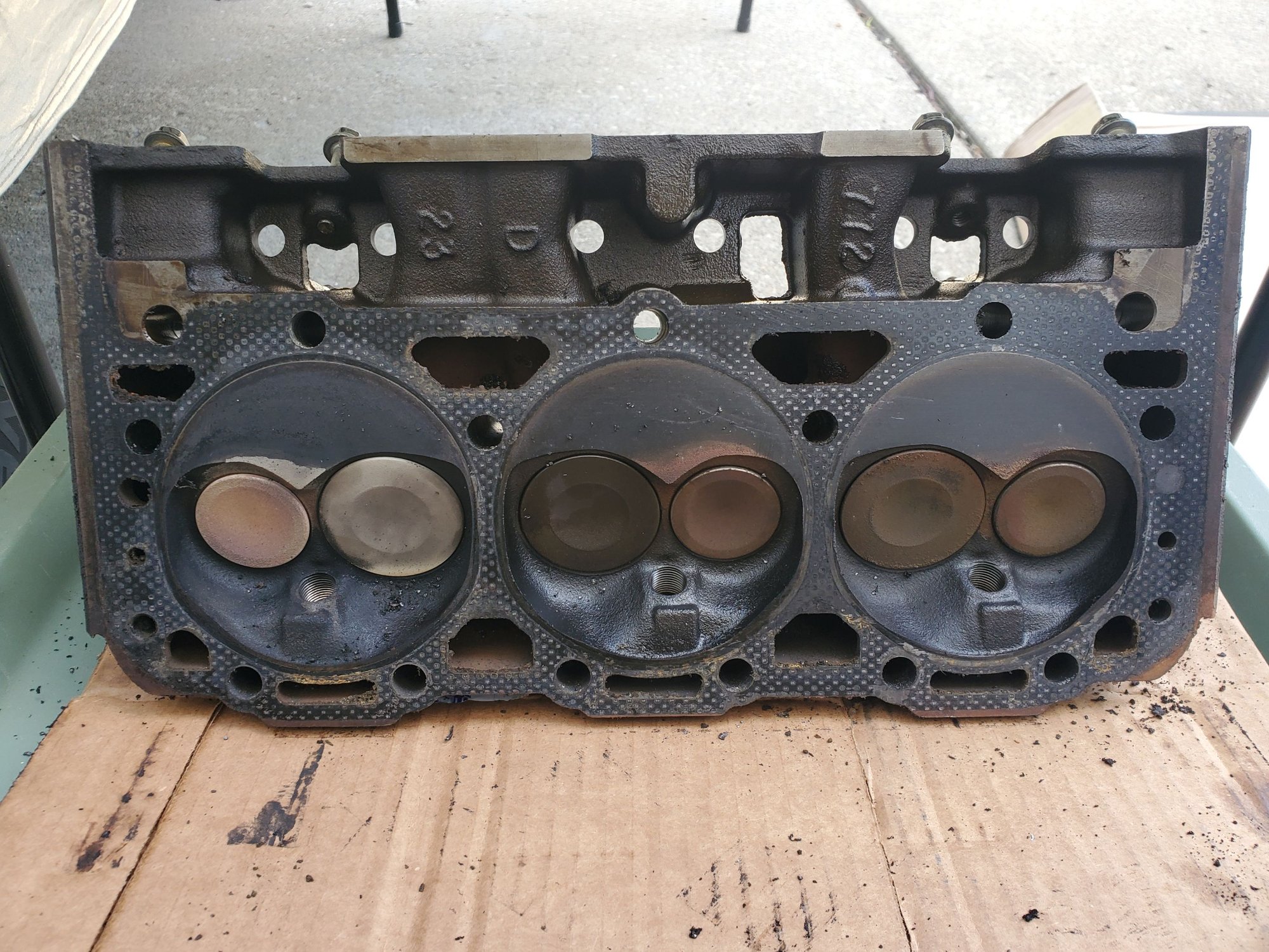

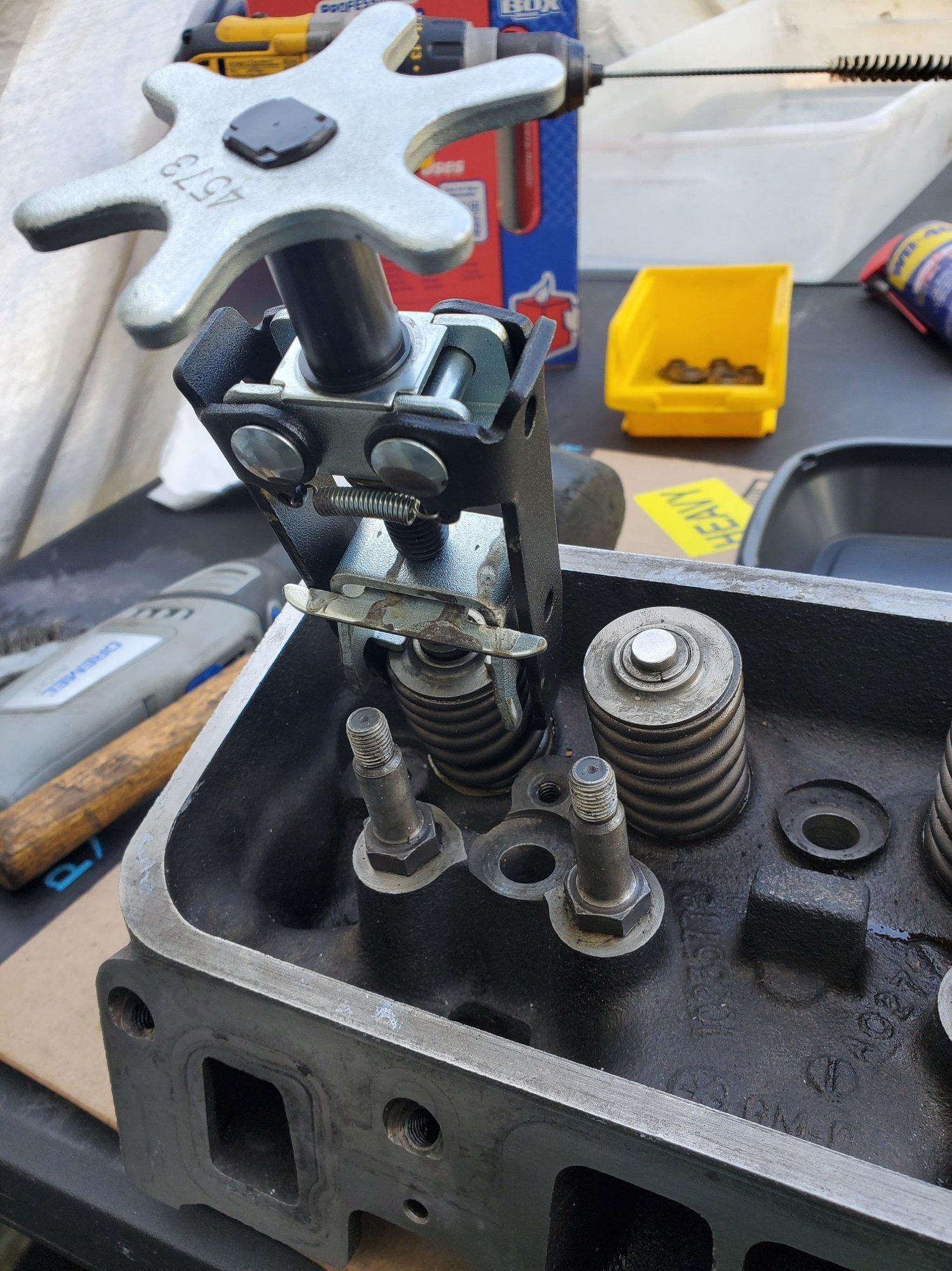

Oh boy, finally getting the head sorted out. Checked all deck surfaces and none are warped. Removed rockers and valves. Used some files and Dremel and ground down/smoothed away all the flash that was on the heads. I got them cleaned and ready for paint. I'm going to resurface and reseat/clean the valves before painting. These are just some random pictures I took.
