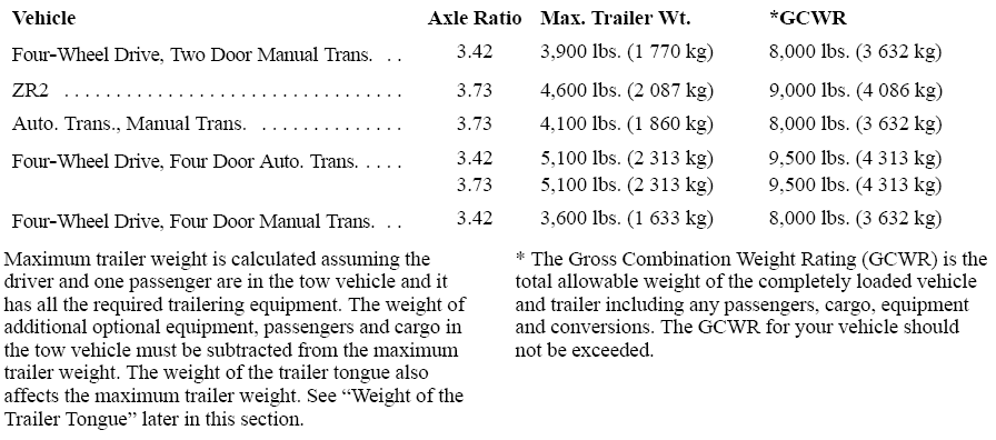

Here's what the owner's manual says:
Attached Thumbnails How much can a 2001 Blazer LT Tow?-tow.gif   How much can a 2001 Blazer LT Tow?-tow2.gif

You still should not exceed the weights from the manual. Those are maximum. If you are using just a bumper hitch ball, you have to stick with the limits stamped on the bumper.
