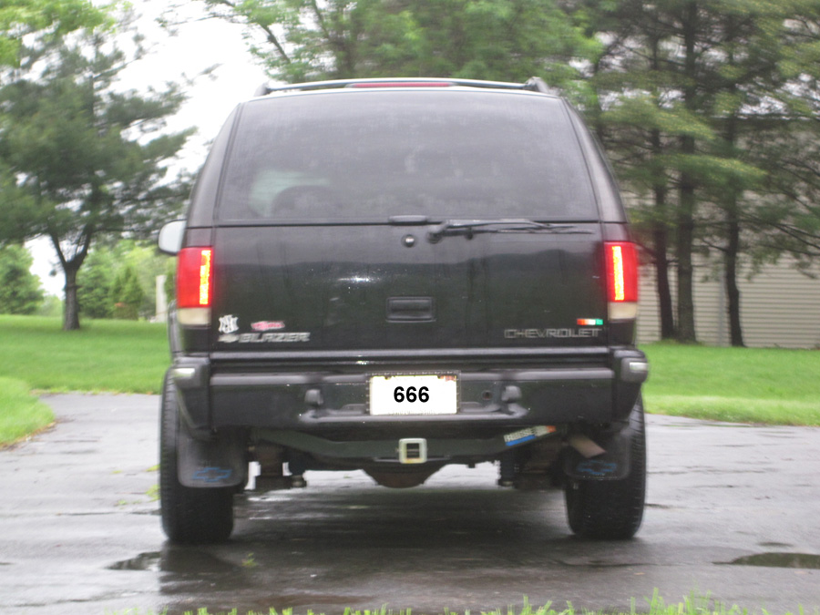

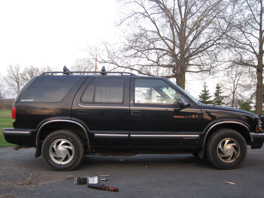

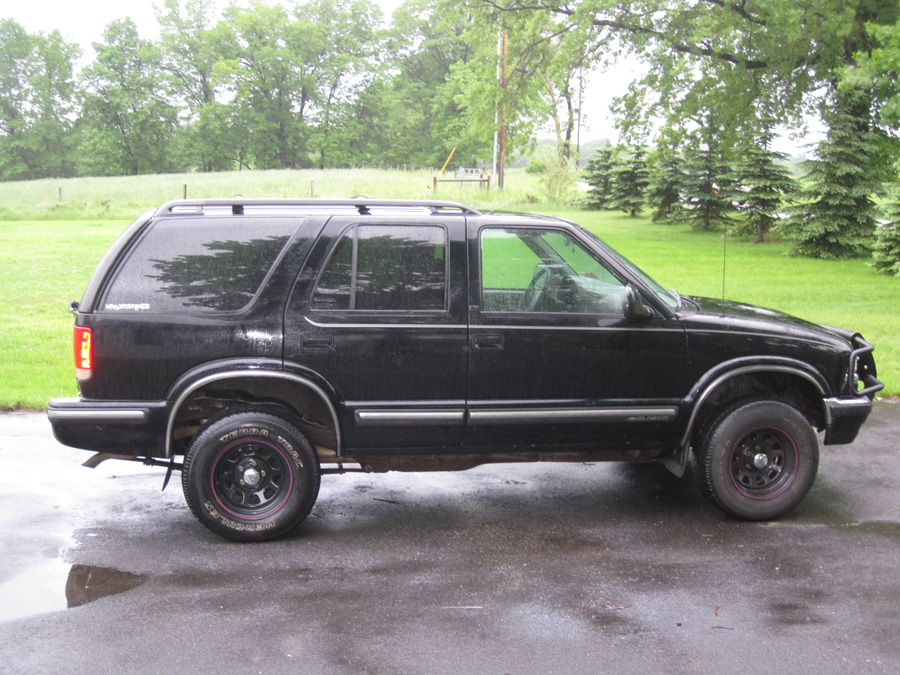

Finally the before and after!!!!!!!
Thanks for the tips and suggestions everybody threw out here! I'm stoked with how it looks, and with the steering work and wider stance, it handles 500% better!
Now to redo the brakes...cake compared to the steering work
