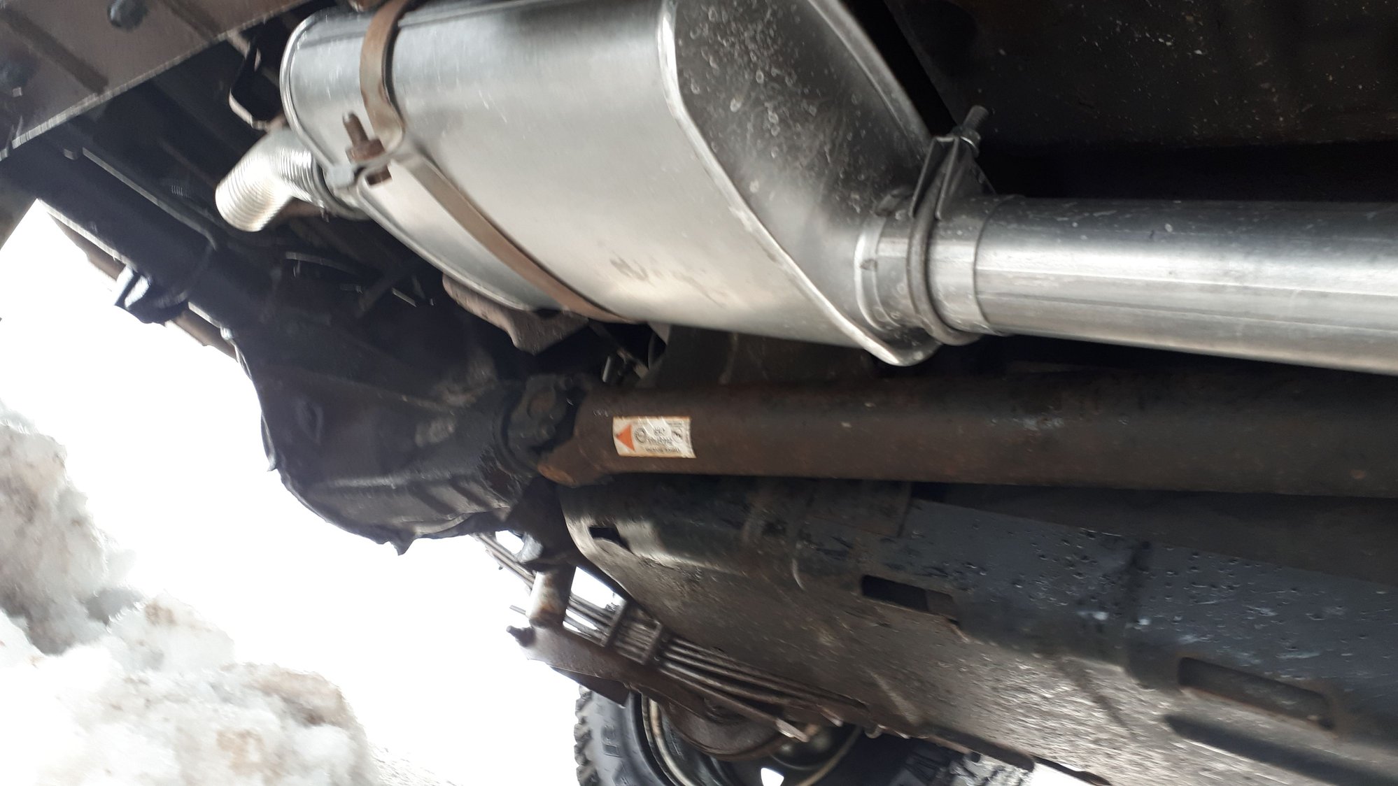

Bandaid muffler repair until summer....
Bandaid muffler...
Year and a half old pos...

Mine was a year and a half old too, on our '93 Volvo 940. More holes under that strap, plus a few more up top.
Parts are utter garbage today ...

Looks like the muffler on my '77 Chevy C10 pickup. The plus is that my straight 6 250 sounds like a 440 now...
