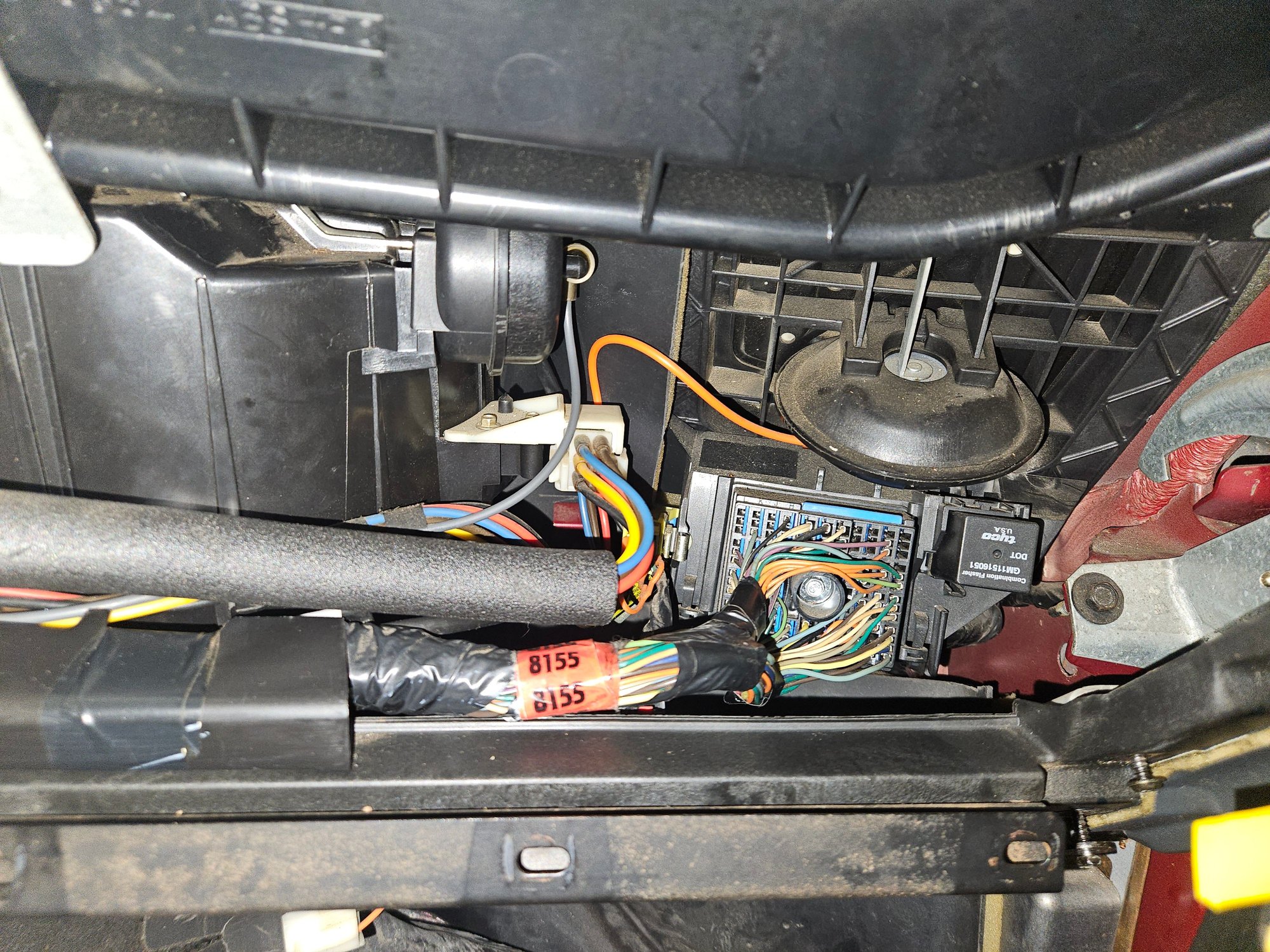

Drop your glovebox (there is a spring in the upper left corner that allows you to do that) you will see a 116 cavity connector (known as C203 on my ’98) that much of your circuits for the interior runs thru (to include ignition outputs, etc). Use a bright light to see if you notice any green crusties or other damage.

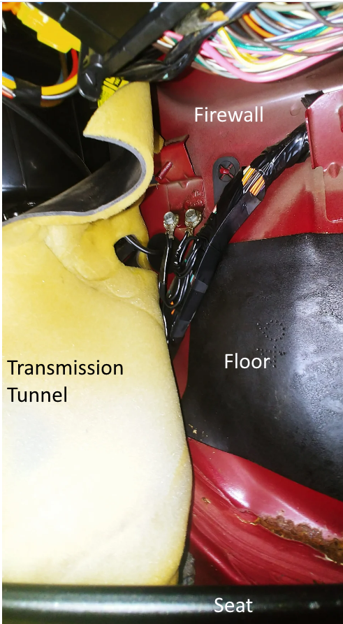

Removing the passenger side door sill and kick panel and will allow you to pull back the carpet AND the black rubber like floor padding underneath the carpet. The bottom side of that padding is basically a big sponge. Underneath that you will see in the pic the bundle of wires as well as two ground locations that you might want to check if they need to be cleaned. Another location for water intrusion, besides the windshield (which I have not personally experienced), these trucks can have a rust through hole where the floor meets the firewall (which I have experienced). Water coming from the fender makes its way into the cab through that hole.
Pull that all apart and let it dry out and then see if you still have the same problem. If the problem goes away, then your fix is to fix the water leaks. I’d also spray the connector down with some DeOXIT or other suitable spray before putting all back together.
If the problem does not go away then you’ll have to start diagnosing to see if the ignition switch or other components are the problem. But I would start with getting those areas dried out, inspecting the C203 connector and the wire bundle under the floor pad for any obvious signs of issues and cleaning those two grounds if they are rusted up.

Here is a pic of the connector C203 (lower right)

Yeah I had those rust holes on both the driver's and passener's side right at the meeting of the floor and firewall. If small enough can clean and fill with seam sealer or JB Weld. If too big might have to weld in a patch.
EDIT: Also note that C203 connector is an excellent location for testing/diagnostics. Easy access and just about everything in the cab runs thru it.
